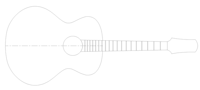

Just thought I would let everyone know in about 6 months of less I will donate a new set of plans to forum library of plans. this will be for what I will call a MJ (medium jumbo), a 20 body 4 5/8 deep, 12" upper bout, 9 3/8 waist, 16 1/4" lower bout for a 25.4" scale. This will be very curvy shape
The plans are drawn but the reason for the delay is I am currently building the first one at present and would like to proof both the guitar and plans before I donate the plans. I think this will be a real boomer for a medium size body length. The typical bad news is; like all my personal designs the body shape will likely require a custom case. I have sent Ameritage the specs and as son as they assign me a model designation for this case I will let every one know the number

I am about to send John the profile and get him to make me bending forms and assembly mold. So I am sure they will be available.

No but could be adapted by relocating x brace and such. It is actually designed around my standard 25.4" neck which spec wise in interchangeable with commercially available High End pre-carved CNC necks supplied by one of our fine sponsors and or pre-carved necks from the three major luthier supply houses. Each of us have our own ways of making necks and neck joints. Just like on my SJ and OM plans leave neck design up to the builder, therefore the X-brace, bridge patch sound hole location is shown based on 14 fret-25.4" scale. If you wish to make a 13 fret-25.4" or any other scale it is up to each builder to adapt. It just boils down to one of those things President Lincon spoke of. (You know! something about all the people all the time)

Oh I so see my quick sketch shows 13th at the joint oops Oh well I through that sketch together on the fly My bad
